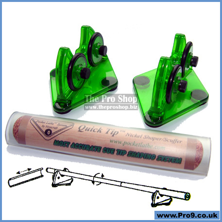

Pocket_Lathe
When I first saw this I thought it was cool looking, but prepared for it to be a bit wobbly, and I tried it on a padded poker table and sure enough it was a little unsteady, but at another event I sat it on a solid shelf and was seriously impressed at how solid and sturdy it felt, and I have sold quite a few now, including one to a very respected cue smith.
Everything you're talking about for around a £tenner!
Check it out here, you can even watch a video of it in use...

I saw that and was worried it would be a tad wobbly. I'll give it a go though. Another problem is, I'm putting a 14mm tip on a 13mm ferrule, so it needs bringing down and burnishing as well as shaping. It looks like the best bet in the long run is to get all the tools in myself though...just a little apprehensive about cues and knifes in the same vicinity!! especially on my first time without a lathe!

Firstly the pocket lathe is basically the same type of assembly I use on my home built cue lathe. Combine one of the with a sewing machine motor and chuck or A.N.OTHER cheap woodworking lathe off've ebay and you have the perfect home cue lathe for next to nothing.
